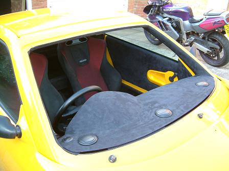

What about some old mini air outlets?
The ones I have in my Libra must be pretty cheap and easy to get hold of, I've never looked tho'
http://www.ricola.co.uk/images/Libra_images/interior_5.JPG
