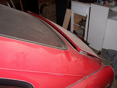

Originally posted by vwfastback
Here is the offset of the decklid when shut.
http://www.thesamba.com/vw/gallery/pix/218320.jpg
This makes a huge difference when driving.

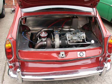

Finally got the accelerator cable sussed out.
It is getting harder to find carb connection pieces around these days. FInally sourced a cable nut and bold to connect to the holley.
To get the cable around the fan shroud, used a 1.5cm length of tube steel. Bent and cut to shape.
Inside that a length of bicycle brake shroud.
The cable is a lenth of stainless steel cable from a boating shop. Have cut to suit.
Found that the problem was the cable wouldn't return.
Went to visit good old bunnings and went through and found an appropriate spring.
http://www.users.bigpond.com/vwfastback/images/100_0559.jpg
Works a treat. Got the idle set up and thought I would try to record it. File is 1.7mg. Am still learning about saving the different formats.
Not much to see really, some smoke and stuff. REducing the file to this size stops the vision of the engine shaking, the movement of the fuel pressure.
You can hear the holley fuel pump initially. I get the car to an idle at 1900rpm and then rev to only 4300 rpm. It sounds good from inside, can't wait to get it to 7500 on the track.
Click here for 1.7m video of Fastback startup
Its close. Soon Boostn, soon.

Hard not to smile with that sound after 18 months of planning and 12 months of having it built.
Prior to the dumping of rain last weekend, I did attempt to get the beast out of a "test" drive to the end of the road and back. (I am on a country road with only 3 house and no through road.)
Could not get the clutch to engage. Raised the car up and tightened the cable. All ok again.
More serious is though, with the engine now in the car, the extra weight of the plumbing and turbo brings the wheel guard down on the DOT tires. No problems with the origional, but they will not handle the power down the track.
I will need to see if I can tune the suspension for the weight, roll the guards and see about machining the spacers. It is close, but not quite ready for the track.
Pulled the plugs as well, and it is running quite rich. Will need to get it tuned correctly. I can tune the idle, but have no idea on the jetting on this yet. Will have to wait until I race to judge the mixtures.
Finally, waiting on delivery of the boost module for the Mallory. Will be able to set it up to alter timing depending on the boost level.
Will update as we get closer.

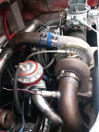

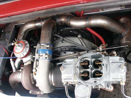

Just sussing out the pix above .Firstly, nice work M8, noiyce!
One thing to consider with Holleys and some downdraft Webers.
They are designed to exploit acceleration G's to raise and lower fuel level relative to the metering block. Ie: the fule runs away from or toward the metering block altering the effective fuel height at the metering block.
This is to enrich the mixture on hard acceleration and climbing hills to help deal with heat buildup and detonation issues, the reverse is true on decel and downhill.
On this particular arrangement, the primaries are in the right side which *can* result in leaning out on hard left hand corners as the fuel will run away from the metering block.
Many Weber and Holley setups inexplicably stall on violent braking at very low speed and this is a major reason as the fuel will run away from the metering block, hence leaning out the mixtures.Its bloody irritating but a fact of life.
Im not entirely sure how things are dealt with with the secondary throats however as at first glance, the reverse must be true and the secondaries would appear to compensate and vice versa. I imagine that Holley wouild be on top of this being a long performing horsepower carb so this might be worth researching further.
It may be a minor point in a straigh line and a relatively low powered/low tech shopping trolley as the change of mixture is insignificant when fuel level changes across the car but worthy of consideration when you start to get serious with this force-fed thing. The thing will be on plenty of boost and revs and not necessarily have the Vac secondaries open.
Many years ago a M8 of mine discovered this with his 283 Chev inboard boat with a 500 2 bbl Holley mounted with the float chamber rearwards. It was done this way due to the ease of throttle cables and lack of knowledge.
As soon as the nose of the boat climbed up from a standing start, the thing would detonate and loose power, yet, it ran beautifully under full power when level and planing.
It required really major jetting and powervalve changes to compensate and the end result was dismal fuel economy and poor W.O.T. performance.
Anyway, enough thread hijacking.
Just something to ponder in your chase for big numbers.

27/8, I ordered the boost retard module for the mallory. It arrived today from the US. Shipping wasn't the problem. Supply of a cable was.
The engine can now undergo some shake down testing. A street exhaust has been added, and limited boost dialed in. Boost 98 from united fuels is the fuel of choice for 15 pound of boost. 10% ethernol in a street legal fuel is a good thing.
All things going well, should be back to the track very shortly. Should have something to post soon.
James C.
Membervwfastback
Posts: 187
Threads: 12
Mood: Ready for Boost.
posted on October 31st, 2005 at 07:58 AM
No sooner than the car is complete, than I am about to pull it apart again.
The engine has been tuned in the car, and the bugs ironed out.
I have never been in a vw like this. I like it.
The boost is an amazing thing. It doesn't come on really until 3 gear, and then not until the revs are high, but when it does, it pulls like a steam train. This is going to be an amazing car on the track.
To give an idea on the power on a set of sticky street yokohamas at the rear, with two people in the car, a launch was tested. First and second gear is noisy and get moving quickly. Third gear revs nicely, then the boost comes on. Changing at approx 6500 RPM, to fourth, the boost stays on.
The car continues to accelerate, straight, while the wheels start spinning due to loss of traction. Tyres then grab and away it goes.
I was happy with that, until I worked back the maths. Changing from 3rd to 4th, the car was doing about 70mph when it started spinning the tyres. (This was of course on a private road...)
I am very, very happy with that.
There is another month until the next test and tune at Heathcote. I am going to take the opportunity to have all the new plumbing HPC'd to protect it. I will remove all the goodies surrounding the engine, and send them off to be protected and made shiny.
I think that I will make my goal with this setup.

Hehehehehe welcome to the world of very larger turbos drawing thru a carby and long inlet runners!!
You wont be wanting keep thats setup for long M8.
When you do change, you will wonder why you ever bothered with the carb. Such is the improvement!
Good luck with it tho.

That looks like a VERY short inlet track to me... Maybe just a huge turbo and doesnt spoll up early???
Alex
l8tr
E
Membershiftyvw
Posts: 523
Threads: 44
Registered: September 11th, 2002
Location: Seven Hills NSW
posted on November 1st, 2005 at 07:35 PM
whats your impressiuon of driving it normally so far? a pig off boost or not too bad?
testing 1 2 3...
Membertassupervee
A.k.a.: Knob Jockey
That really hurts doesnt it!
Posts: 1171
Threads: 25
Location: Huon Valley SouthernTasmania
Mood: Moody!
posted on November 1st, 2005 at 08:47 PM
Err.... you call that short??
Id call it at least a meter from the carb to the valve plus a plenum on top of the runners just to stall things up further. Big volume, long distance.
Believe me dude thats seriously L o n g!.....
For a pull-thru carb setup that is.
L8tr
E
Im not a complete idiot, quite a few parts are missing....
MemberAlex Holzl
A.k.a.: Big Al
2332cc of pure BALLZ!!
Posts: 1550
Threads: 85
posted on November 1st, 2005 at 08:51 PM
oh yeah for a setup like that, but not compared to your normal intercooled setup...
alex
Membertassupervee
A.k.a.: Knob Jockey
Posts: 1171
Threads: 25
Mood: Moody!
posted on November 1st, 2005 at 09:41 PM
Waaaaaay long, however not much choice with a pull-thru arrangement on a boxer engine.
I would have retained the original Weber setup and blown thru them.
Webers make an excellent turbo carb with some minor alterations and with the carbs directly on top of the inlet ports, things would happen really nicely on that setup.
The length of the tubing bact to the turbo then becomes irrelevant.
Throttle response and driveability increases/improves dramatically, boost lag decreases significantly and intercooling becomes a reality.
Fuel condensation in all that tubing does not happen when cold and tuning becomes a far simpler affair with very little variation compared with the mixture variations on a pull-thru setup. You can NEVER get it right most of the time.
I have utilliesd both draw-thru and pull-thru affairs with a variety of carbs on the same engine and the difference is absolutely spectacular apart from absolutely wide open throttle on boost!
However, I did find that the mixture atomisation from passing thru the compressor resulted in, at the end of the day, slightly better fuel consumption in the draw-thru setup every time.
The only trickery for blow-thru is an EFI fuel pump and a boost controlled fuel pressure regulator.

Vollkommen Art
http://thesamba.com/vw/gallery/pix/231896.jpg
[ Edited on 8/11/2005 by Boostn ]

Vollkommen Art
http://www.thesamba.com/vw/gallery/pix/231895.jpg

Vollkommen Art
http://www.thesamba.com/vw/gallery/pix/231893.jpg
