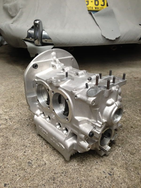

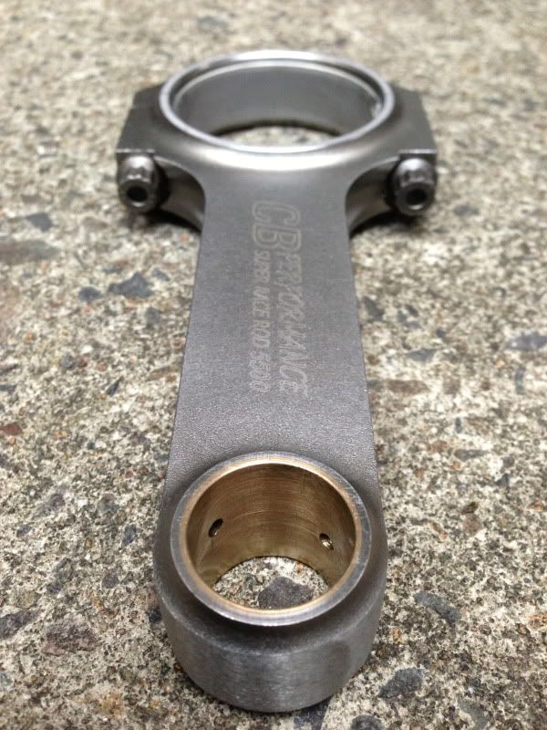

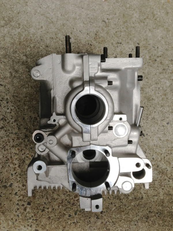

I thought I would share this build with those who may be interested, its a mates engine we are building for a Manxter

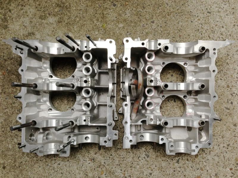

CB super race case 3.5mm deck

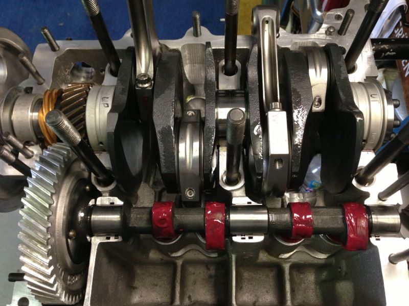

CB 82mm crank 8 dowel
CB 5.5 H beams
AA lightweight flywheel
AA 92mm thick walls

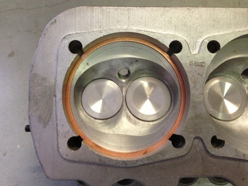

DRD hand oval ports 58cc 42x37 0.020" step
1.25 rockers
FK43 108 L/C straight up heli gears
CB Ultralight lifters
CroMo studs and push rods
CB Throttle bodies
Microtech ECU

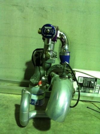

Twin IHI VF14 turbochargers with custom intake and exhaust.

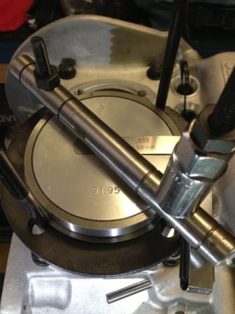

The mock assembly with above combination netted 0.003" deck, with 0.020" in the head I will be installing 0.060" copper head gasket from CB
CR is 8.57 static 6.58 dynamic with plans of running 8psi boost.

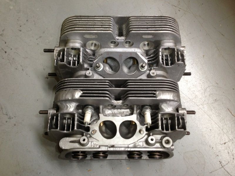

Another head to choose from after a slight massage
http://i105.photobucket.com/albums/m208/benito26/file_zps4e6ab181.jpg

Oil pick up
Check around where the oil pickup tube goes to it the block.

Anyone else have issues with AA cromo flywheel mating to the CB crank?
Memberdebiasi4
Posts: 283
Threads: 51
posted on March 26th, 2013 at 06:05 AM
Those AA flywheels are not very good on the clutch surface. Found it was not very grippy surface and glazed up easily.even when resurfaced. I ended up going back to lightened vw flywheels on anything that made decent power
Cheers Adam
posted on March 26th, 2013 at 08:19 AM
^^ me too, the AA flywheels aren't a patch on old German VW. I know one of Australia's best clutch specialist that has offered to buy any old VW flytwheels to use the clutch surface material in his custom alloy flywheels. It is in his opinion the best material he has ever experienced in his 40+ years of building clutches.
Recently I chucked a new replacement in the bin due to the flywheel mating surface being so poorly finished, it appeared it would have damaged the crank quick smart.
German all the way for me too.

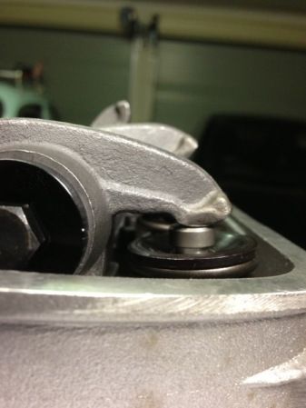

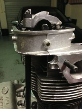

will sort out the flywheel issue later, I've just been messing around with setting rocker/valve geometry....I hate doing this,
find full lift 0.383
half it 0.1915
mark half lift
install adjustable pushrod and rockers
set rocker parallel to head, adjuster inline with pushrod, rocker tip 90* to valve stem
I'm close but not perfect, seems rocker stand needs a trim or thinner lash cap
http://i105.photobucket.com/albums/m208/benito26/file_zps31e8703c.jpg
http://i105.photobucket.com/albums/m208/benito26/file_zps3174c2c4.jpg
Also got the 0.060" copper head gaskets checked out, now get this rocker geometry right.
