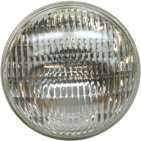

Do you mean for upright headlights or slopers? For slopers it's a no. For upright, maybe. Depends if overall diameter fits and the adjuster screw loactions line up with the Chrome headlight rim.
I'm thinking you want to do this as these sealed units can be bought far cheaper than what VW vendors sell similar parts for?
posted on December 19th, 2016 at 08:01 PM
with early sloping headlights you can buy a US style housing with a clear glass over the top for a late Beetle you will need to do some fettling, fit some 7 inch universal bases and use the rim as a cover. Buy good quality semi sealed beams that take an H4 bulb

I think Steve is trying to say you can get a lot better lights with a good H4 globe in a semi-sealed beam that you can with sealed beams - and they are readily available to fit straight in - in upright headlights anyway

The op asked for SB7.
http://www.sparkshop.co.nz/images/parts/19-SB7.jpg
You would also have to fabricate a parking light.
As I said, why?
