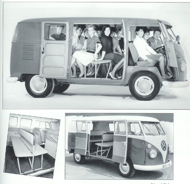

Just as long as you don't have to go for this option....
http://www.thesamba.com/vw/gallery/pix/131482.jpg

Not that many kids thanks but wouldn't mind the Kombi :)

Hey but kids and their friends add up Scott!

Aha so that is a 15 seater!
Would get hot in summer, defintley need safari's.
:D
Memberbaybuscamperkid
posted on December 24th, 2003 at 03:11 PM
u beat me to it helbus, and if u look closely there's only 12 people inside! so thats why they show no interior pics of those brazilian 15seater kombies!

Those Brazillian 15 seaters must look funny full of people, chooks and baskets. LOL
They would have to drive with the sliding door open in those humid conditions. :D
