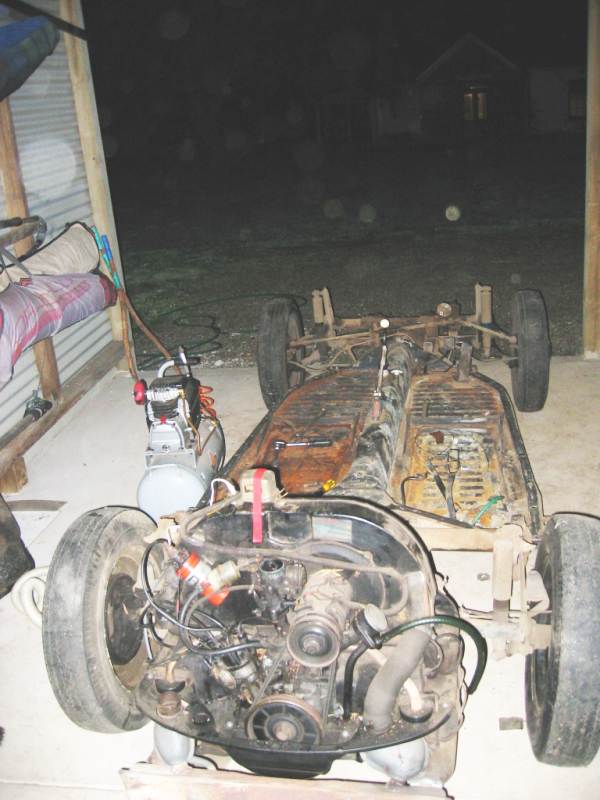

my floorpan
replaced the right hand rear quarter, patched the front left footwell and made a new section for the left front rail
a coat of rust killer, then a couple of coats of flat black rust cure paint (after a shitload of wire brushing, sanding and grinding) and it's nice and solid again!!
