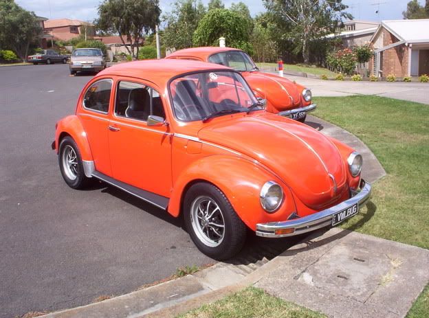

Hi peter,
Tried to send these u2u but to big sooooooooo here they are:beer
Cheers Doc
http://i21.photobucket.com/albums/b280/beerdoc/leoandken001.jpg
http://i21.photobucket.com/albums/b280/beerdoc/lowered.jpg
Cheers Doc
