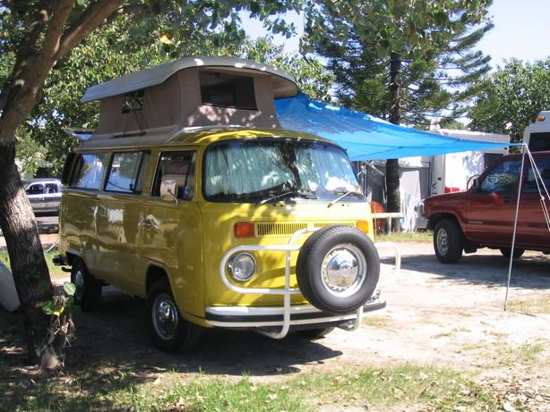

Several months ago, I learned from Ian J. Lloyd, in Swindon, Wiltshire, England, that a relatively common modification, made to Australian 1968~79 VW Type 2 Kombis, is that of changing over, the front-windscreen tandem wipers, from the standard, left-hand drive configuration, to the more appropriate right-hand drive configuration, whereby the right-hand front wiper, sweeps into the top, right-hand corner of the windscreen, maximising the zone of wet-weather vision, for the driver
http://www.vwkombi.com/
At the start of a several months' long, extended tour of Australia, commencing in January 2004, Ian had purchased a second-hand, 1974 VW '1800' Type 2 Kombi based, Sopru hybrid campervan, named "Ethel" (see Ian Lloyd, "Going Down Under – Falling in Love with a Cliché...", VW Camper & Commercial, Issue 19, Summer 2005, pages 40, 41 & 43), which he later shipped home to Great Britain
"Ethel", featured in the magazine article and on Ian's Internet website, can be seen to have this LHD to RHD, windscreen wiper conversion, including black, rubber blanking grommets, in the original wiper-spindle holes. This conversion is also evident, in several photographs taken at VW shows in Australia, of various Australian 1968~79 VW Type 2s, posted at the following Internet website URLs, plus a very recent photograph of Phil Lovett's all-yellow, VW 1974~79 VW 1600 or 18/2000 Type 2 Kombi:

They came from the factory with the 2 sets of holes, I believe that its only the wiper arms that are different. 1303s also had 2 sets of holes down here as well.
