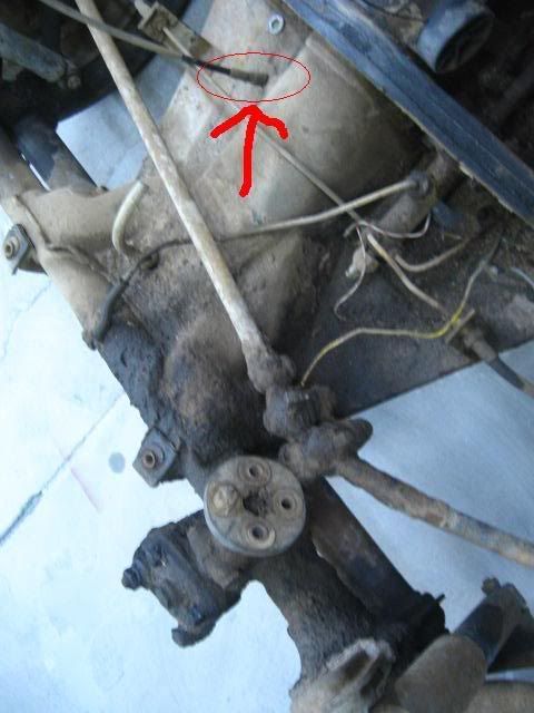

here is a pic, best I could find.
its left hand drive, but gives you an idea of where it goes in.
I cant remember if it goes in the other side on RHD.
http://i119.photobucket.com/albums/o143/xornge666x/chokepicSmall.jpg
I would be more inclined to run it along the floor pan on the inside where the steel brake line runs, and exit the rear of the pan on the other side to where your battery cable goes to the starter. A LOT less work, and when you put decent carbs on it you can just pull it out!
I would also probably look at other carby options before going to all that effort just to suit a carb thats on the engine.
You could also look at the single 40mm solex kit available now with electric choke.
Or a good old 34pic3 (std 1600).

posted on February 9th, 2007 at 07:31 PM
It is in the same position on RHD pan
Grahame

posted on February 10th, 2007 at 09:15 AM
Thanks very much for that fellas,
