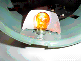

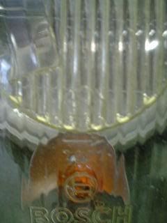

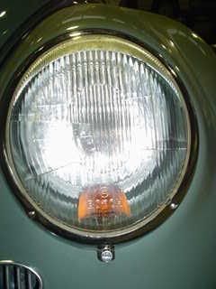

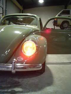

Here are some pix of some headlights I did on Kim's 60 ragtop a while ago.
I used some aftermarket headlights, which were available at the time for around $50 ea.
The chrome on them was cheesy, and I had all the chrome re-done.
They are a 356 style headlight, with clear lenses, and have a regular 21w ind/brake bulb in the spot you have your side marker style light there. I installed a reflector from a 67 beetle front indicator, so the blinker were visible even when the headlights were on. Without the reflector in there its VERY hard to see the blinkers at night, and we needed to do them this way to pass engineers. They take a H4 globe, and also have a parker light in them.
The clear lenses that came with the kits are not ADR approved, so we used original Bosch lenses to make it all legal. You could either get some genuine porshe lenses to replace them, or use the aftermarket ones. The beam with the aftrmarket glass is kind of bad, and would not pass roadworthy.
