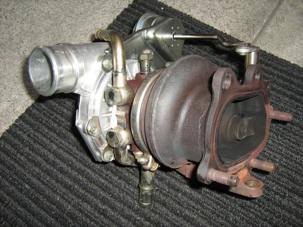

You guys know what turbo i have? the engine i think is a early Jspec RS turbo.
feels like it needs a upgrade its boosted to 14 PSI at the moment. is there any turbos that will bolt straight on that will increase performance with out breaking the bank?
IHI VF28 which I think was standard on the V3 or V4 Sti's. Takes really well to boost, easy 20psi and does not lag as much as some of the other VF series. When it comes on boost and well tuned pulls hard to redline, well it did in my old Forester GT which pushed 170kw atw at 16psi.

Member72type3wrx
Posts: 152
Threads: 61
Registered: August 29th, 2006
posted on November 7th, 2007 at 10:33 AM
So i must have a VF24 right?
if i made 130ish RWKW before on 14lbs and im after the magic 200 RWKW what turbo should i be shopping for?
will the VF30 be able to flow enough to make the extra ponnies? or will i need a VF22?
also what mods will be involved to do the swap over?
And looking at my pics do you guys think i will be able to do the swap over with the engine in the car?
