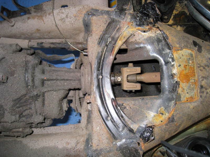

the chassis number is stamped into the chassis just infront of the gearbox coupler panel
it can be hard to see if theres rust/dirt/paint over the top
its just noticiable amonst the rust on this floorpan
http://i63.photobucket.com/albums/h136/P8KSY/George24Dec07013.jpg
HTH
