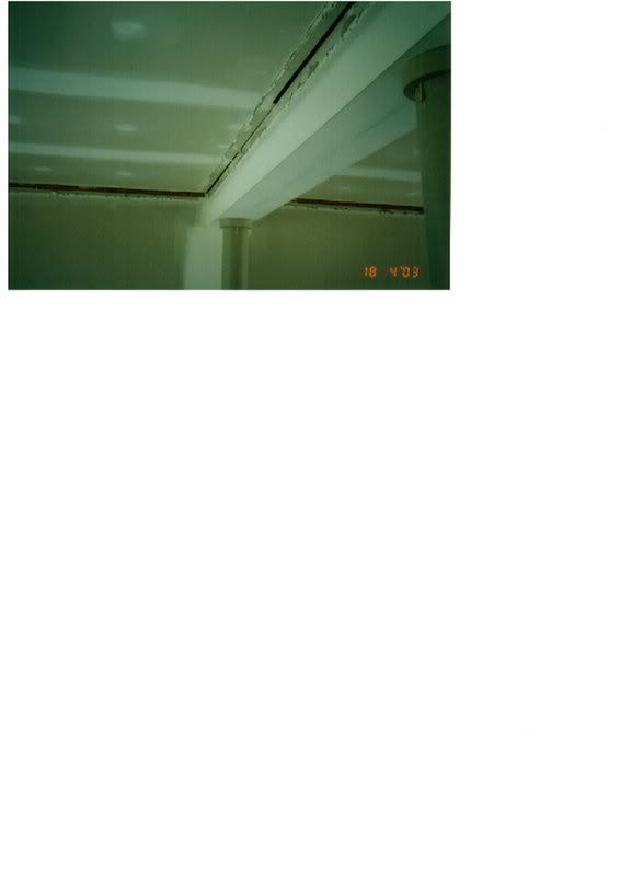

• Ceiling in verandah to be level with front bit in front of dar beem. Supervisor asked us what level did we want it we told him and he agreed yes we can do that. It’s now a different level even after I also marked it with a texter.
• Bulkhead to short in formal living room. They have just tacked timber frame onto plaster board.

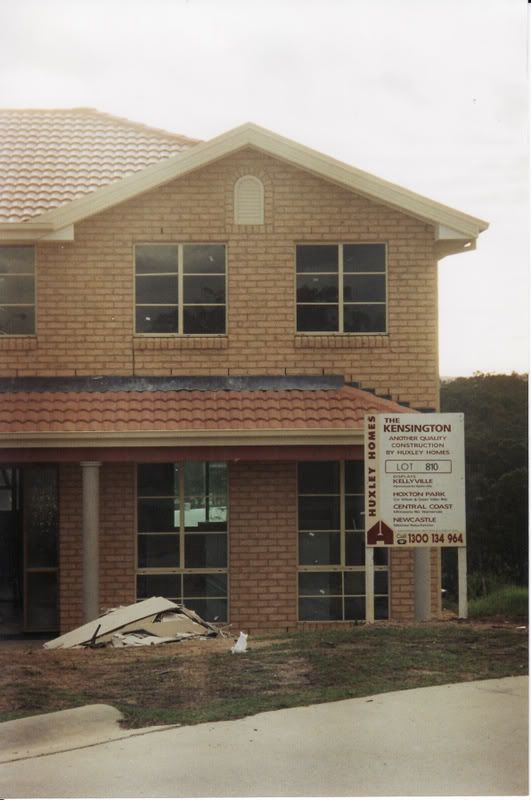

• First floor gable and vent and windows all out of symmetry.
• Removed and replaced all of the bricks and roof trusses rearranged in the top gable to correct the symmetry and also all the brick work in the garage gable removed and replaced. This must have been a big expense.

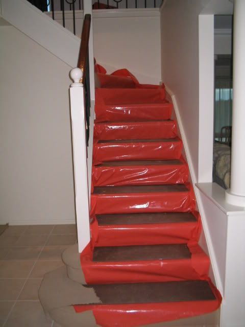

• Post and railing on stairs have big scratches in them.
• Timber missing at top of stairs in the floor.

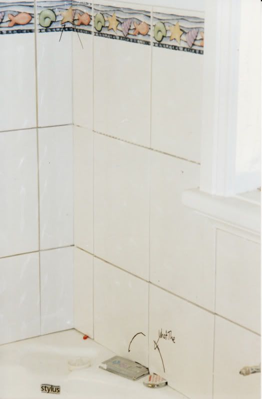

TILING ISSUES
Laundry
• Grout coming out of floor.
• Tiles are not fixed to the floor as you can hear that they are hollow underneath.
• Metal edge strip sticks up on entry.
• Grey grout on walls instead of white.
• Grout rough on walls.
• Fan cover came off and is in the wrong spot not ducted to external wall.
• Can’t put washing machine hose in tub as it leaks underneath.
• All tiles on every wall are all uneven.
Powder Room
• Grout coming out of floor in several places.
• Sealant missing on top edge of tiles on walls.
• Grey grout up walls and around outside edge the tiles on edge have been cut uneven.
• Tiles on floor drumming.
• Fan on wall doesn’t work correctly.
• All grout is rough.
Ensuite
• Grout coming out of floor in a few places.
• Grout missing on step in shower.
• Tiles uneven on step to shower.
• Metal edge strip is not even.
• Freeze tiles have all been cut and have very sharp edges that you can cut yourself on.
• Tiles have moved on corner of bath tub very uneven.
• No sealant behind top of wall tiles.
• Water doesn’t drain away correctly in shower recess floor.
• Toilet coming off of floor.
• Colour variation in tiles above bath.
• Cut tile in corner above bath.
• Light in wrong spot.
• All grout rough and unable to clean.
• Tiller tiled over red dot.
• Tiller tiled over bad tiles on hub.
• Should only have 2 rows of tiles on top of tub.
• Sharp edges on tiles under window.

pic of where tilers tiled over switch for spa. And they even still grouted the tiles in over the switch after we had told them that you couldn't turn the spa on with the switch half in the wall.
They redid the tiles in this bath room 3 times before it was totally gutted.
http://img.photobucket.com/albums/v419/montem/IMG_0001-3.jpg
a pic of bodgie tiling

Pic of where the gable had to be moved over as the decorative arch wasn't central. before pic
http://img.photobucket.com/albums/v419/montem/IMG_0003-1.jpg
This is a pic of when they had done the move after they said our house was finished at lock up.
http://img.photobucket.com/albums/v419/montem/IMG_0004-1-1.jpg
