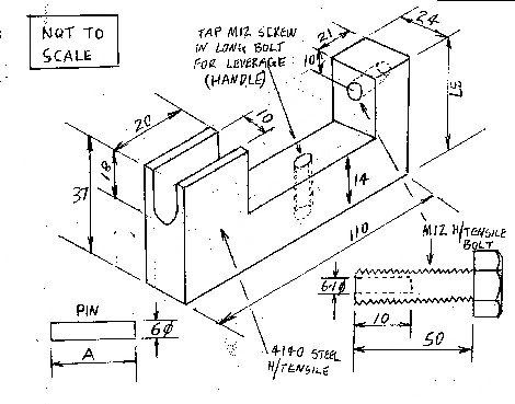

like this one?
http://img.photobucket.com/albums/v225/mrvw061/vw%20stuff/hingetool.jpg

posted on December 6th, 2008 at 10:02 AM
I might see if a friend can make some of these up....
