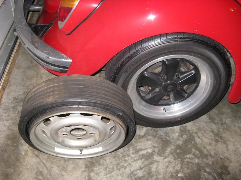

no you pump em up and they are as round as a beetle tyre
[img][/img]
