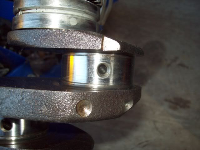

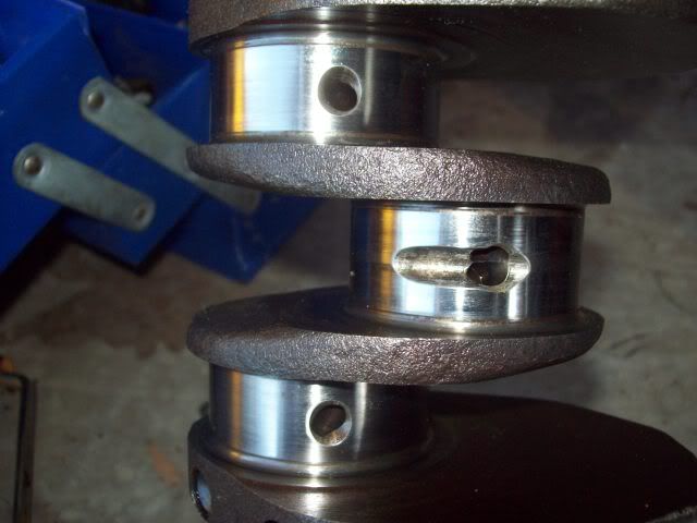

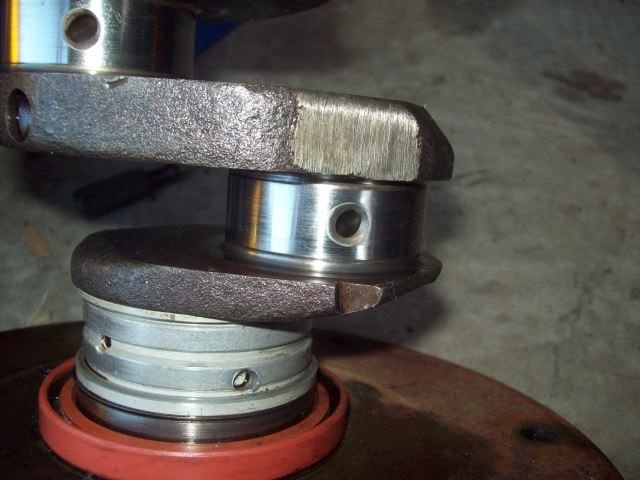

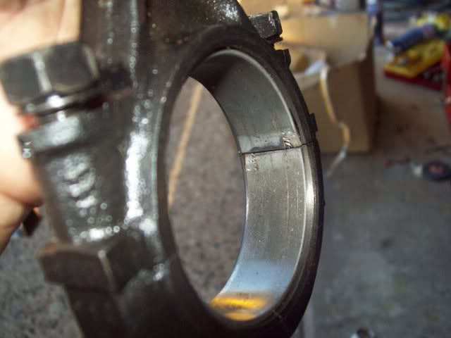

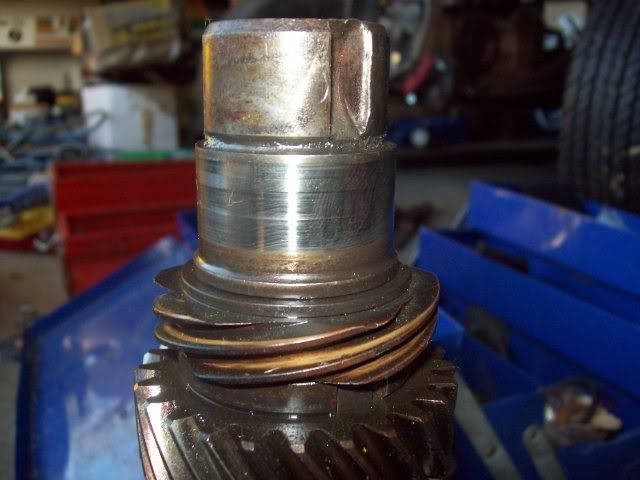

What do you think about these main and big end bearing surfaces?
By the looks, looks like a stock 69mm vw crank.
I stripped the motor completely cause every conrod was able to rock back and forth (slightly) when pushed back and to front of motor.
They weren't sliding across, or moving while pushin in and out, just were rockin at an angle.
I was after a more experienced opinion. Thanks for looking. Any help much appreciated!

Looks like time to have the case and crank mic'd, may just need polish (un likely) but bearings look pretty shot.

That key way is shagged.
Remove all the bearings and torque the case and rods to spec with all nuts and bolts.
Take it to a place that can measure it all for you.
The crank may take a polish,(and a keyway repair!!!!!!)
but without measurement I am just guessing to ease your pain.
I would say your reason for disassembly was of no concern.
But the keyway repair required a total strip down anyhow.

Mate, it really shouldn't cost much to get the case line bored and the crank reground. Then it's new bearing and away you go and I wouldn't of thought the keyway would cost much either. Find out first before you thro it away. :)

get some 1200 wet n dry paper n cut into strips bout the width of the crank journals and polish back n forth to remove all the crap from the crank
you will have to get a micrometer n measure the ovality in the crank so at 90 degree increments to see if its out of round or worn NO SHORT CUTS HERE must be measured properly
you will find if the cranks been ground or what ever USE NEW BEARINGS regardless and you will have a good long lasting engine
BUT prior to all that as per dangerous clean the case and bolt together and have it checked to see if it can or needs machining on the face or the tunnel this is the NUMBER one priority if the case isnt good then the engine wont be any good regardless of what you do to the crank or bearings
