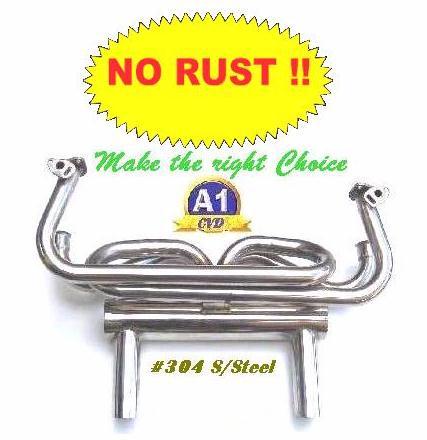

GT2 exhaust?
Anyone have one of these exhausts fitted to their 1600 Beetle? Just wondering what the exhaust note is like and quality.
http://www.classicveedub.com.au/images/SpareParts/best_cvd/gt2-norust-cvd1.jpg

Yes,
In my opinion the quality is pretty darn good for the $$$$.
Note is better than standard pea shooters, hard to describe really. Initially I wasnt sure I liked it but now I dont really mind it. Not quite by any means. depends what your after. I bought it for the ground clearance & the fact that its an extractor system that exits the stock location.
Heat riser attacments are not fully welded nor are they drilled through. So a bit of reworking is required if you want to have a fully functioning heat riser pipe on your inlet manifold.

I also have this exhaust
As said - for the money it is brilliant
http://i35.photobucket.com/albums/d170/blue74l/exhaust/100_2220.jpg
I have modified mine so i have a flange connection
http://i35.photobucket.com/albums/d170/blue74l/Marty/101_1206.jpg
I have been told the new ones have the heat riser fully welded and drilled.
The heat riser doesnt work as well as a stock whick "flows" from right to left - these will just pulse.
Personally i think most of the heat comes from conduction

I have one of these sitting in my garage unused as i was told it would fit on a full size oil cooler.. unfortunately this wasn't true.

posted on May 27th, 2009 at 01:05 PM
it wont fit with an oil pump that runs out into a filter
as i have tryed ;(

posted on May 27th, 2009 at 01:53 PM
Bugger! The motor I just bought has hi-flow pump and filter. Thanks fellas - saved me some hard earned there. So what what exhaust system will fit? I prefer to use stock exits if possible.

posted on May 29th, 2009 at 08:27 PM
theyre only good for something with stock heads and only very mild carbs i wouldnt put one on anything more than kdogs
ive got a brand new one sitting under the house, found out they dont clear full flow pumps
i also dont like the fact they still fweem cos they tail pipes are baffled
sounds so wrong having a nice deep note but still fweeming like stock peashooters

I got one of these exhausts in my project car, awesome quality and mine did have the heat risers holes pre-drilled and fully functional, but I'm not using them now due to twin carbies being fitted. You can see more info and photos in my blog. The pros of this exhaust are:
-exits through stock holes, heat risers can be used, atainless steel, dimensioned larger extractor pipes. Basically, it sounds like the stock exhaust but louder and with a sportier deeper note. And itstill makes the magical "shwoosh" sound that the stock pea shooters make, but flow and sound much much better. Noticeable power and torque increase over stock too!!
Cons:
-makes about 2 to 5hp less than full flow 4into1 headers, from what I've seen on overseas engine dyno tests. On a stock twin port 1600, the 4into1 made 66hp and the GT2 made 62hp. Stock exhaust made 54hp. Please note though that they did advance the timing and tuned the carby outside of factory specifications for the 4into1 and GT2 exhaust tests...

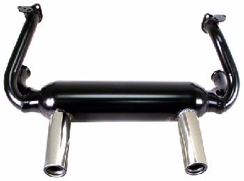

posted on May 31st, 2009 at 07:47 PM
with those specs you could get away with running tri-mill euro style systems
they actually have better ground clearance than those GT2 and stock mufflers and will clear all oil pumps and filters
http://www.classicveedub.com.au/images/SpareParts/muffler_exhaust/7252.jpg
i notice george is now selling them in staino too
there not 4into1 but they still give a 5hp increase over stock muffler according to vw trends muffler test
http://www.vwtrendsweb.com/tech/0109vwt_volkswagen_exhaust_test/index.html
they dont sound to bad either bit on the loud side but not as much as a phatboy
someone at warwick drags had a volksrod with a 2376 and twin webers with one of those

nice joel, never seen them before.... look pretty compact which is good... gt2 on mine used to scrub after i lower my bug.... do they still run baffled tips? hard to tell from pic but looks like they do...

the original tri-mills do but im fairly sure the empi ones have them as well
http://www.morepower.dk/IMG_0003.jpg

mmmmm, the name empi scares me when talking performance parts..... i dont mind their accessories but was always a bit iffy when it came to their performance bits, and then after i heard about their batch of weber style carbs with porous fuel bowls it put me off even more

what is that one it looks nice? have you heard them?
posted on June 2nd, 2009 at 08:44 PM
the original were tri-mill euro twin tip
but empi are doing a knock off
george has stock and stainless i would say they're the empi version
they have shitloads of ground clearance and room for oil pumps/filters
they have a nice deep note but a tad on the loud side
