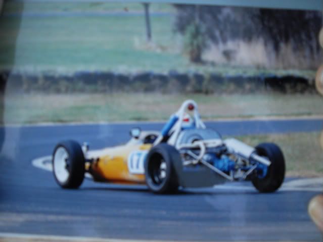

Ill send you the proper scan Ian, but here is a photo of the photo...
http://i163.photobucket.com/albums/t289/dmulally/SDC10633.jpg

Looking at that photo the car was already in Hill Climb/Sprint mode:
- Wide with tyres
- Standard muffler
- Wide fan housing
Still interesting the car was built in the first place I suspect that the car is a CMS with bits added on.
CMS Vees are typified by having two massive bottom rails.
http://i35.photobucket.com/albums/d164/chequer57/32IMG_0310.jpg
This is an unmodified chassis example.
Formula Vee, preserving engineering museum pieces in Australia since 1964
