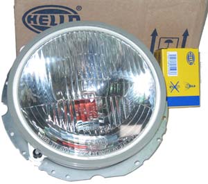

clinker, the vw semi sealed are a bolt in job on late model bugs, the mounting brakets are already there
thats all i run with 100/80w artic blue xenons and like jeff said they crap all over most modern car lights
george has them for $79
http://www.classicveedub.com.au/images/SpareParts/headlight_taillight/cvdS-8011.jpg
or the ugly 3 chamber ones with foglights for $59

the semi sealeds have vertical and horizontal adjuster screws just the same as stock, there just underneath the headlight rim on the frame
all 68 on gaurds have the mounts for them just bent over flat
this was because US had sealed beams since 67

I did the conversion on my daily, I was running Narva +50s they were much better than high wattage halogen bulbs and don't need relays etc, I used these in Hella H4 semi sealed beam units.
I'm going to go with some Narva Arctic blues next.
To convert to sealed beams in an early car you can actually buy US spec headlights that will hold a sealed beam unit, putting better headlights under another set of lenses defeats the purpose.
The fully sealed beams aren't much good, better of with the semi sealed beams.
