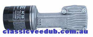

maxi pump (with the filter on front as I will take the strainer out because of the mini sump) $.. (classicveedub)
