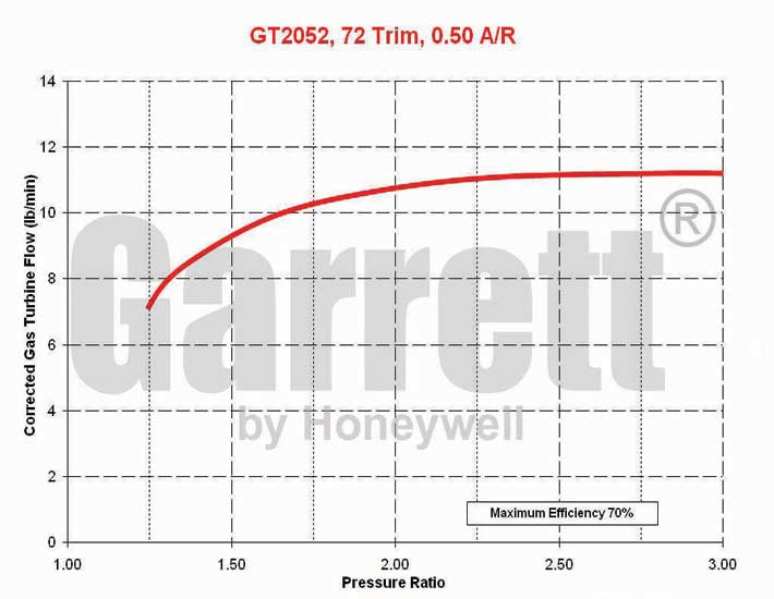

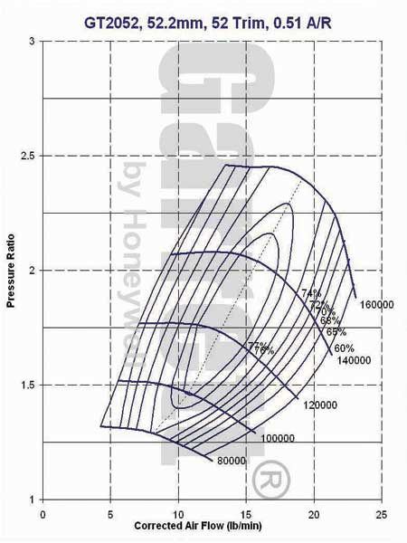

I have a garrett gt2052 turbo which is new and unused and I want to fit it to my 1776 type 3 running megasquirt efi.
The compressor a/r is .51 and 52 trim , and the turbine a/r is .50
According to my rough calculations it seems to be absolutely ideal for my 1776 as a low revving street driven car with gobs of torque.
Compressor map here: http://www.hpheaven.com.au/uploaded/pdfs/Garrett%20Compressor%20map/727264-1&2comp_e.jpg
Turbine map here: http://www.hpheaven.com.au/uploaded/pdfs/Garrett%20turbine%20map/727264turb_e.jpg
Also found this handy turbo calculator: http://www.squirrelpf.com/turbocalc/index.php
So far it appears to be a pretty good match to my engine and hp target of 150hp with room to move
Will be using subaru w/a intercooler, stock type 3 efi manifolds and type 3 semi hemi (56.7cc) heads with stock valves...
Thinking either stock cam or maybe engle 100 to keep the broadest power band.
Advice would be greatly appreciated!
Cheers, Toby

What boost you want to run ?
