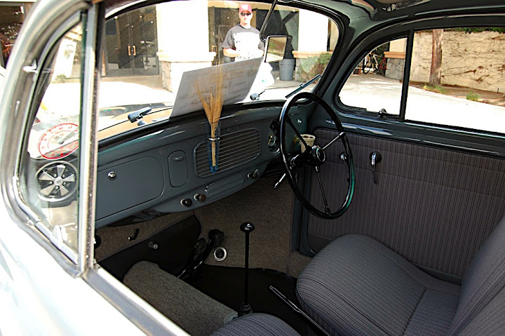

rebel
Posts: 181
Threads: 48
Registered: June 14th, 2008
Location: Kellyville
| posted on January 13th, 2011 at 03:03 PM |
goldie
dash looks like this
[img] [/img]taillights are like this
[img] [/img]

| posted on January 13th, 2011 at 07:33 PM |
looks like an oval to me

| posted on January 13th, 2011 at 08:06 PM |
goldie
had a good look today has later rear decklid and no backwindow amazing what you can see in the daylight have taken out speedo dated 56
[img]http:// [/img]
still has engine gearbox interior and seats seat belts tailights headlights etc

| posted on January 13th, 2011 at 09:24 PM |
| Quote: | Originally
posted by pod
was just thinking the same thing
vw54
| posted on January 14th, 2011 at 06:03 AM |
looks like an Oval to me as well with late engine lid and 40hp taillights
Joel
| posted on January 14th, 2011 at 09:49 AM |
thats all oval cept the taillights.
W decklid is oval.
68AutoBug
| posted on January 15th, 2011 at 12:23 AM |
| Quote: | Originally
posted by rebel
looks like a 60 from outside but has features of early bugwhite batwing steering wheel fatter tailight housing no w on back decklid early type
frontend hupcaps have a slight lip half way from outer to inner floor rusted out old guy said take what parts i want going to scrappers apparently
[img] [/img]some parts already scored
that is an oval beetle with W deck lid -
batwing steering wheel -
early jack... vw off the bonnet is a late one...
should have been pressed aluminium -
what is the round thing in the dash next to the speedo..>?
type 3 handle on handbrake upside down...lol
tail lamps are NOT tombstone but 1962>1967 tail lamps..
No semaphores [trafficators] is strange... to take them out??
no holes at all???
LEE
68AutoBug
posted on January 15th, 2011 at 12:31 AM |
Definately a W deck lid.....
what does the number plate look like.??
does it have a flat piece of plastic or glass for lens?
oval steering wheel horn button and wheel...
ignition key should be on the LEFT hand side..
where the 3 white knobs are....
Headlamp lenses with VW at the top are old type lenses...
vertical flutes.... no cut off...
LEE
hubcaps sound early too..
Joel
| posted on January 15th, 2011 at 08:43 AM |
| Quote: | Originally
posted by 68AutoBug
no holes at all???
LEE
Square thing to the left of the speedo is most likely an old period fuel gauge that was availble back then, and the other round thing to the right is
another gauge probably temp or ammeter.
It wasnt uncommon for people to bog over the semaphores and fit later indicators, seen several like that over the years
All ovals had the ignition key on the very right hand side of the radio where this one does, it was only big window cars that have them on the left.
