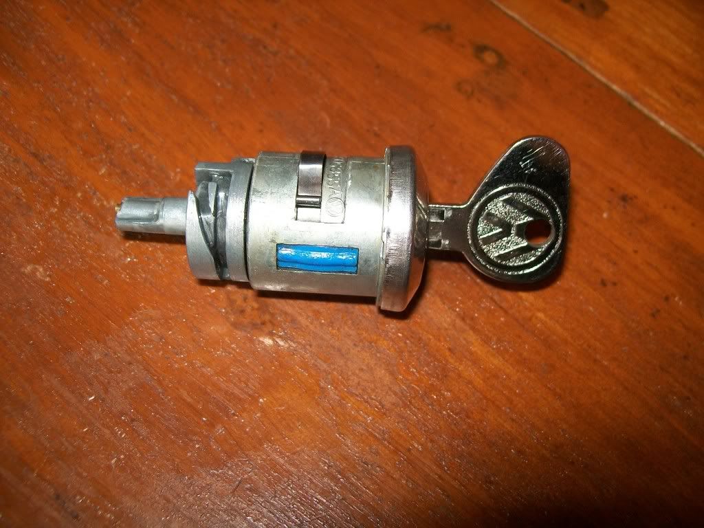

Membervlad01
Posts: 4270
Registered: June 3rd, 2010
Location: Kyneton, VIC
Mood: Side ways
posted on July 19th, 2011 at 09:19 PM
I bought this > http://cgi.ebay.com.au/ws/eBayISAPI.dll?ViewItem&item=150622010223&ss...
and it arrived today. I stripped it of the wafers and ended up using all but one. but since the ignition barrel have one extra wafer I am still in need of 2.
One really :dork: as I had a good used one from another door barrel but none of the last type I need.
So now I have the whole thing soaking in prep wash as the gunk is so bad the springs are jammed in there and some of the wafers just jam up.
Slowly getting there:rolleyes:
Also order nos huf keys to code.
