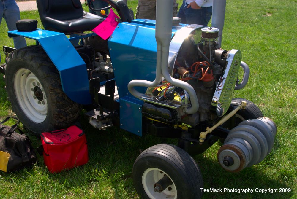

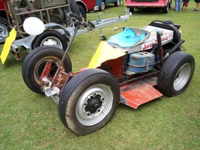

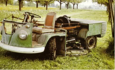

Originally posted by Marilyn71
Just a PS. Not really on the subject... but its amazing what you spend on a ride-on and I compare that to the price I bought my Bug. I could have bought 2 beetles for one new JD!! :spin:
On that note maybe Pauly should consider these?

The mowers in those photos posted earlier... well I'd be interested to see some of them race at Warwick.... or maybe not race at all!!
