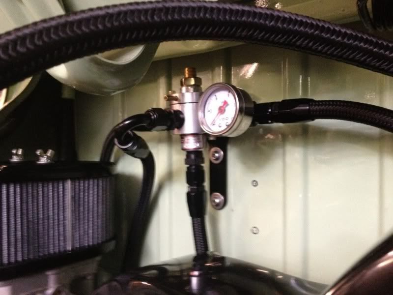

Member66deluxe
Posts: 1593
Threads: 139
Registered: August 16th, 2005
posted on June 4th, 2012 at 05:01 PM
Clean your idle jets. Mine was running like shit the other day so i checked the idle jets on my Dells and one was blocked. Put it back in started it up and happy engine again. I used a mallory regulator with bypass valve.
Damo.
http://i31.photobucket.com/albums/c366/66glook/58ce1d35.jpg

see in ur pic ive only got a t peice no gauge or nothin
