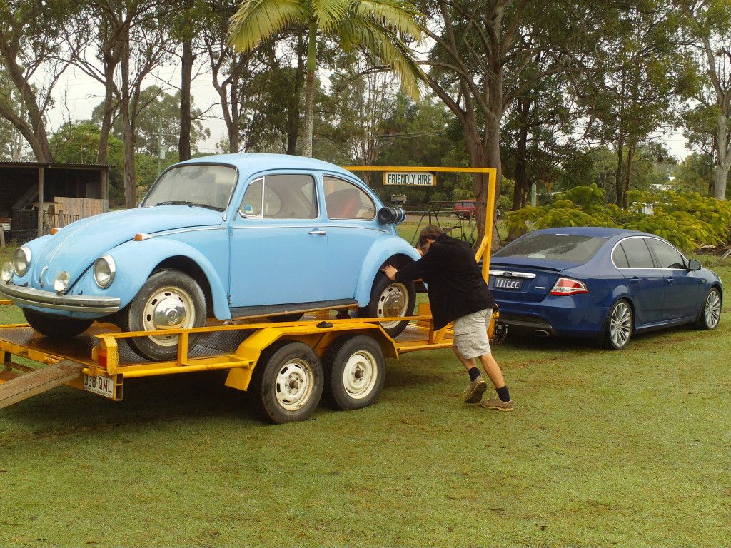

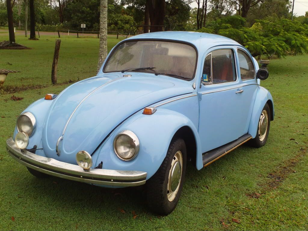

recently we set out to find an old school Beetle to do up, and stummbled across our Edna. i am led to believe she is a '68 1500, manual. Originally a daily driver, she had been in a shed for the last 10 years.

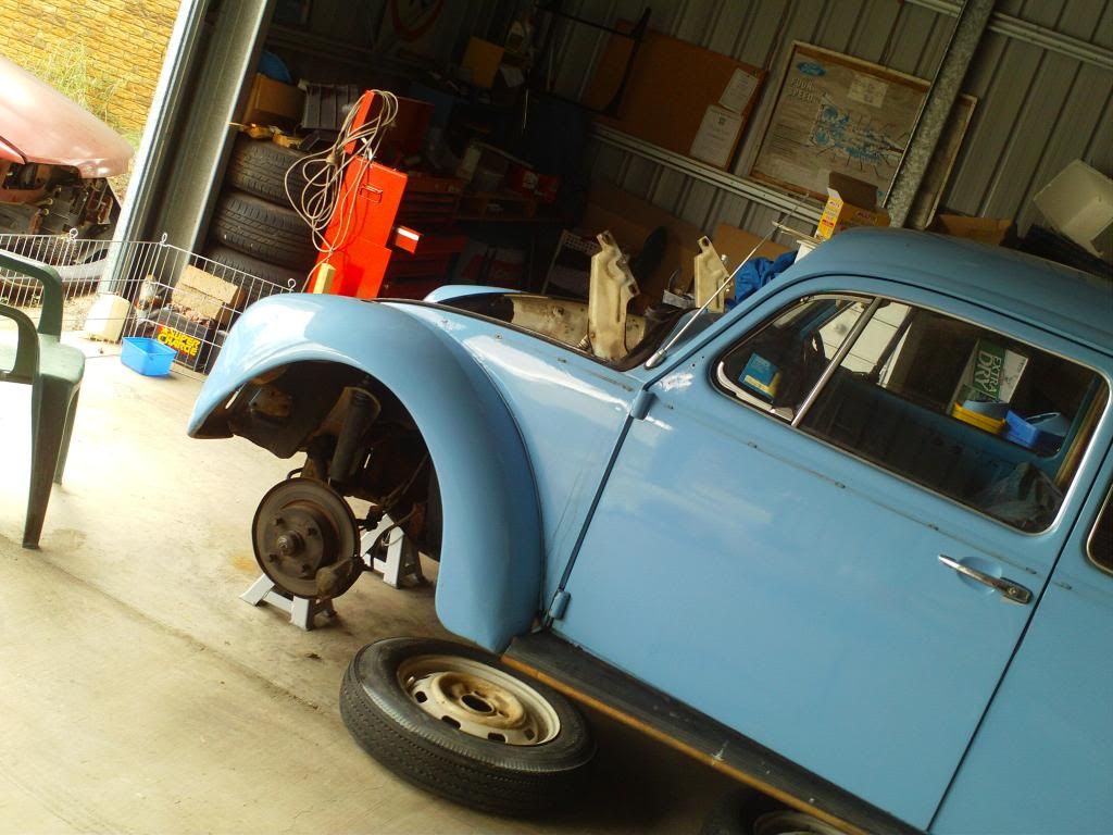

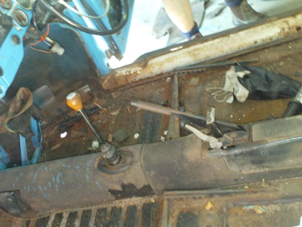

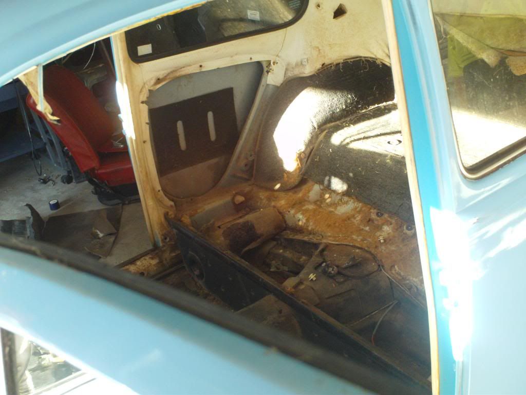

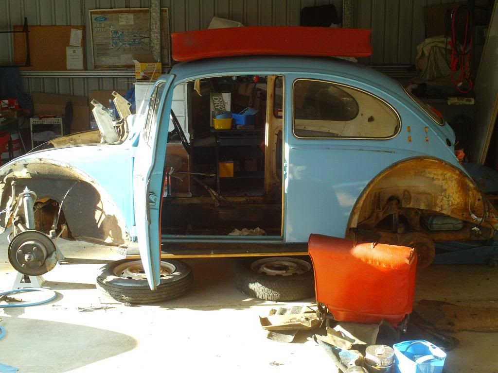

so finally the shed got cleared out and the teardown begins..... lord what have i gotten myself into??
http://i204.photobucket.com/albums/bb7/v8falconsrule/edna%2068%20vw/FILE0793.jpg
[IMG]http://i204.photobucket.com/albums/bb7/
v8falconsrule/edna%2068%20vw/FILE0804.jpg[/IMG]
http://i204.photobucket.com/albums/bb7/v8falconsrule/edna%2068%20vw/FILE0852.jpg
http://i204.photobucket.com/albums/bb7/v8falconsrule/edna%2068%20vw/FILE0853.jpg
fast forward 6 hours and this is the current status-
http://i204.photobucket.com/albums/bb7/v8falconsrule/edna%2068%20vw/FILE0886.jpg
http://i204.photobucket.com/albums/bb7/v8falconsrule/edna%2068%20vw/FILE0884.jpg
http://i204.photobucket.com/albums/bb7/v8falconsrule/edna%2068%20vw/FILE0882.jpg
i had no idea how easy these little cars are to pull apart, the only components left in the car are the engine, gearbox, steering/suspension, and fuel tank. :blush:

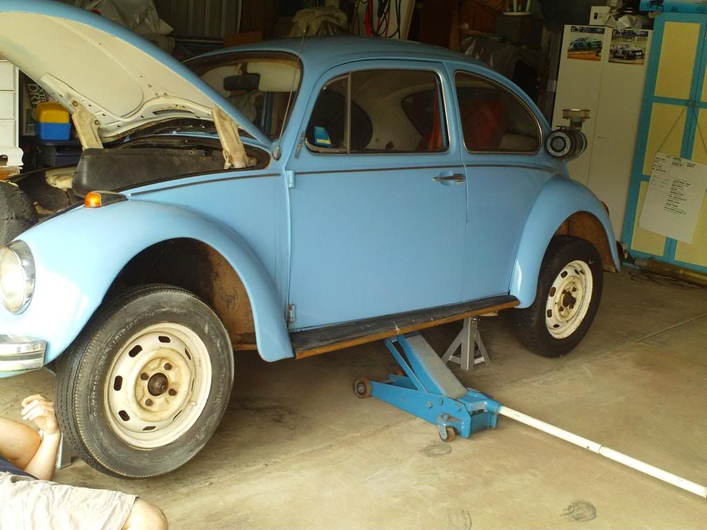

posted on November 14th, 2012 at 07:45 AM
welcome
looks lucky the body didn't buckle when on the jack
not the best jacking point that one
look forward to the progress pics :tu:

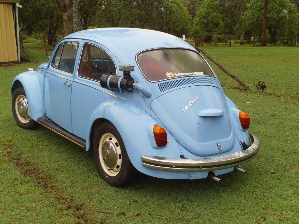

posted on November 14th, 2012 at 08:44 AM
Welcome to here, looks like an excellent starting point.
You keeping it stock or mod it?

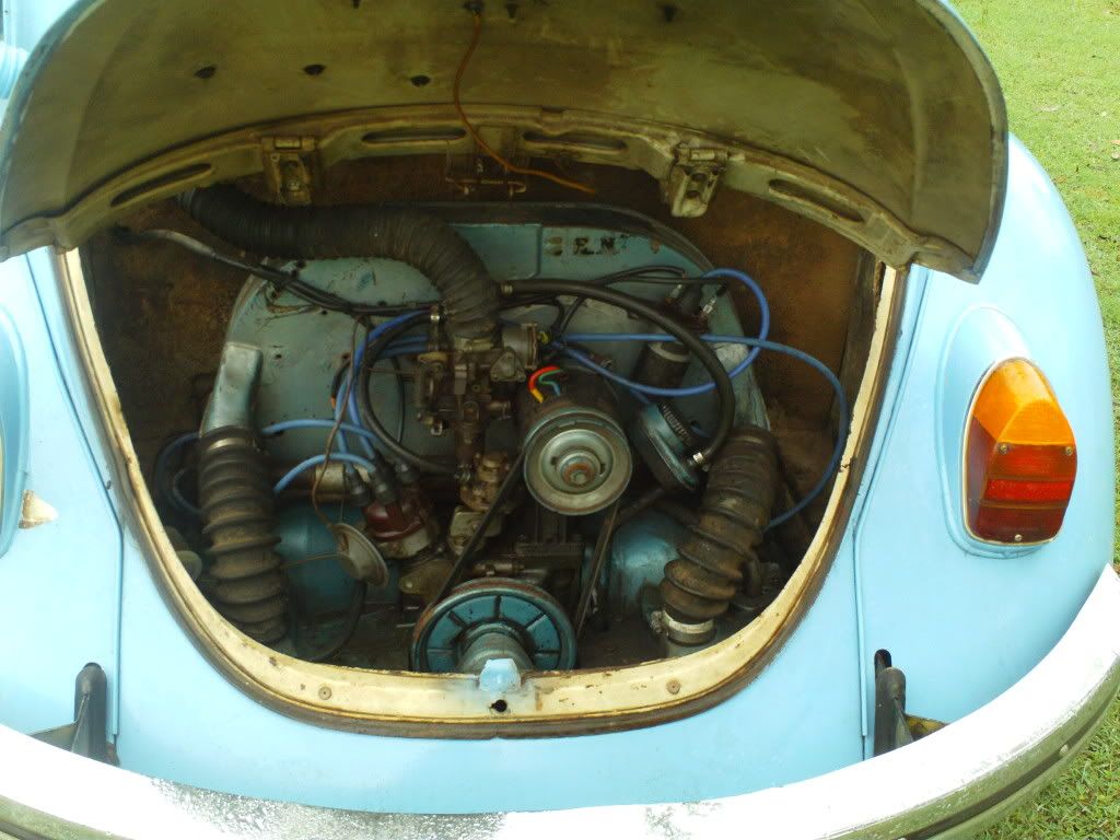

Where the hell were they driving it to need that old Donaldson Barrel filter?
Down the mines? :crazy:
Membercam070
Posts: 1332
Registered: July 25th, 2009
posted on November 14th, 2012 at 04:41 PM
Haha I was going to comment on the disappointment with the removal of that "forced induction" system lol
Looks like a solid starter and good luck with it. You are on a journey now!

I wasn't sure about the jacking point, the original jack tube is bashed to bugggery, so I used the seam and watched for crushing.

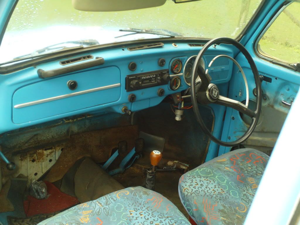

alrighty guys, i need some help identifing Edna. While i beleive she is a 68 model with a 1500, i can't be sure. i have the chassis number from under the seat, which reads 118.76.5244 the decimal places may actually be rust spots.... the problem i have is that i can only find examples of 68 numbers ending at 118 1016 100..
how can i verify Ednas actual age (it is impolite to ask a lady after all). also i found a sticker in the glovebox lid stating the case ( i pressume the engine case) has been replaced, how can i be sure it is a 1500? is it a case of measuring the bores and the swept area of the piston?

Does she have a fuel door release near the drivers right knee?
1969 1500

no fuel door release that i have seen, the fuel flap is able to be opened from outside, just spring loaded, with a lockable fuel cap. there is a bonnet (front boot??) release lever on the lhd side of the dash, unknown if factory or added later though.

posted on November 21st, 2012 at 04:48 PM
Both
If it has no fuel door release definitely a 68
69 on ward had internal release and per 68 had internal filler,
