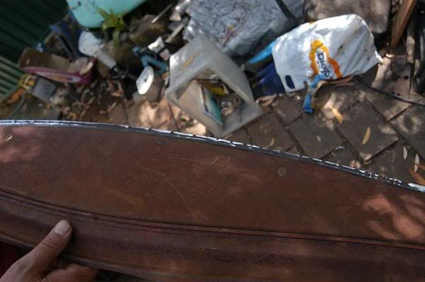

(sorry about the background - rubbish cleanup weekend) - this is the "new" panel that will be used to fix the rust under the windscreen

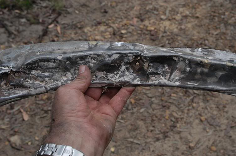

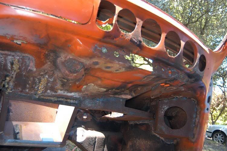

I've got an engineer mate with a nice $8,500 TIG welder, who will be doing the windscreen fix. Here's why its needed:
http://i240.photobucket.com/albums/ff112/igatenby/Vwa1.jpg

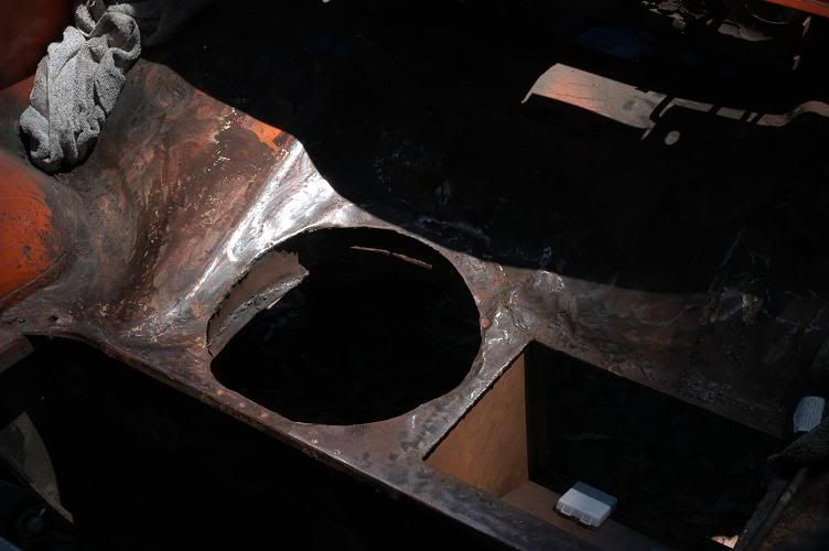

In under the fuel tank and subwoofer there's the hole for the speaker and battery:
http://i240.photobucket.com/albums/ff112/igatenby/VWA2.jpg
I'd be interested to hear people's views on this - not forgetting the strengthening underneath though:
http://i240.photobucket.com/albums/ff112/igatenby/vwa3.jpg
That's a 1" square steel beam, plated up to the firewall - the rust isn't an issue, just a bit of surface rust that disappears with a wire brush. There's also a couple of brackets in the centre - under the radio area that hang an under-dash aircon unit sourced from a Mazda.
So - strong enough? Legal to have a hole through the firewall? I can't imagine it is illegal - given the holes in the dashboard for radios, etc.

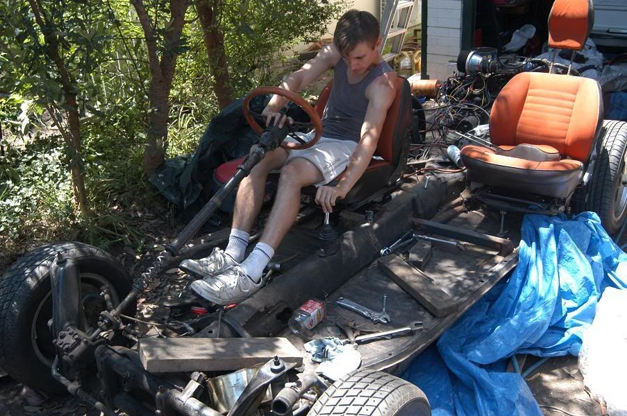

We set up a water tank and ran her till she warmed up yesterday - with the exhaust on. She may even pass the noise meter test. Its a 3" system from the turbo back and includes a catalytic converter.
Here's Shorty discovering that he can't drive it. This is with the seat full forward. He can't get full throttle, among other things. :lol:
http://i240.photobucket.com/albums/ff112/igatenby/shorty.jpg
That'll teach him not to eat his vegies when he was younger. He's only 6' 1 1/2" tall.

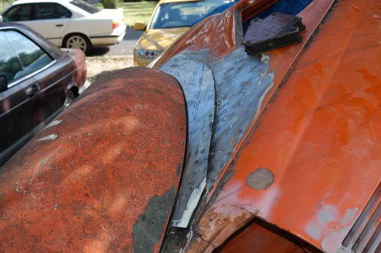

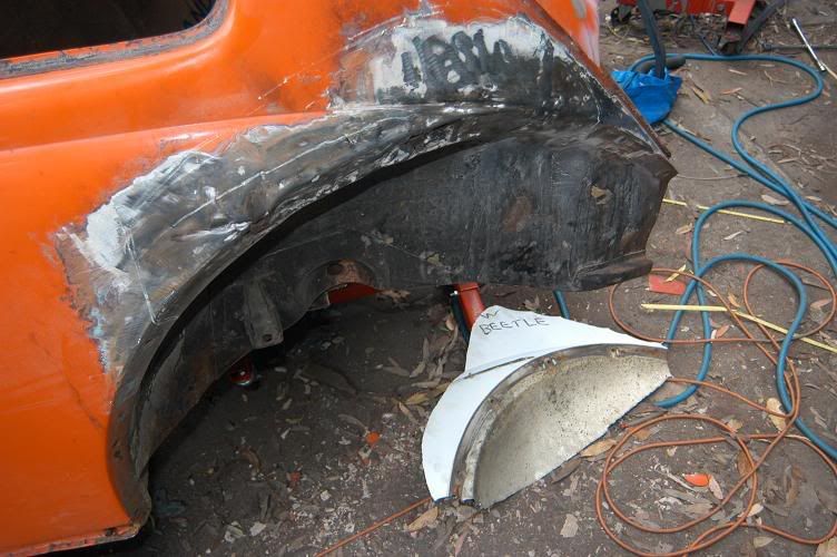

Had some fun with a wood chisel and the TIG yesterday and today.

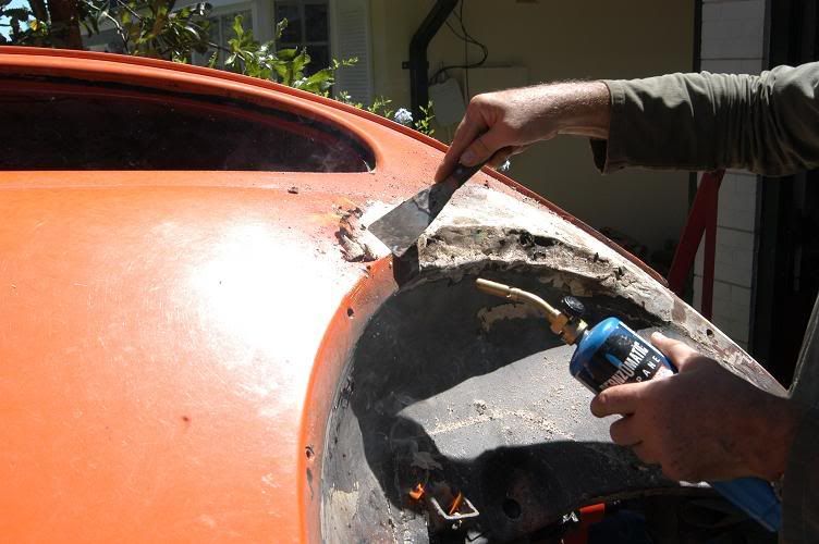

Here's the first bit - digging out up to an inch of bog
http://i240.photobucket.com/albums/ff112/igatenby/Vw1-2.jpg
The offending piece underneath
http://i240.photobucket.com/albums/ff112/igatenby/vw4-1.jpg
Yep - the woodchisel was the go - like a hot knife through butter. $35 for this bit.
http://i240.photobucket.com/albums/ff112/igatenby/vw3-2.jpg
Lining up the bolt holes with an old guard
http://i240.photobucket.com/albums/ff112/igatenby/vw5-1.jpg

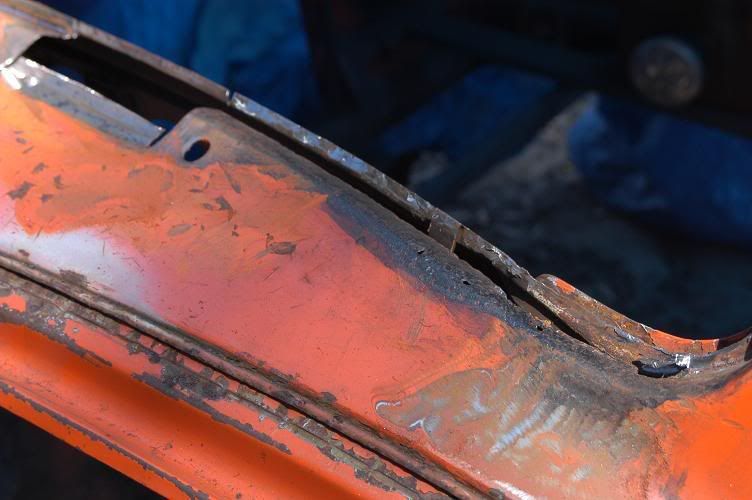

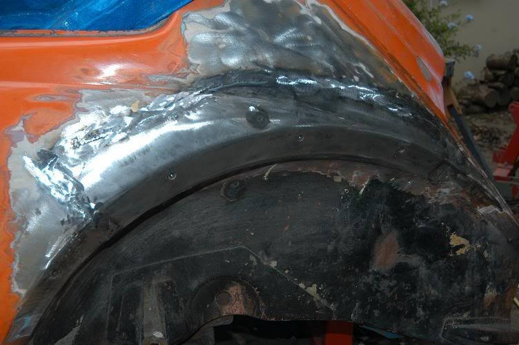

Tack it into place with the TIG
http://i240.photobucket.com/albums/ff112/igatenby/vw6-1.jpg
Stitch it up an inch at a time, then hit it with a flap wheel on the angle grinder. Got a bit more to do, but the neighbour came home just then - and those sparks go her way. The last of it can wait till tomorrow. I got a slight depression at the front weld - the gap was a bit bigger - I probably should have cut it back and welded in another strip - but it's only about 2mm down and I haven't taken to it with the hammer and dolly yet.
http://i240.photobucket.com/albums/ff112/igatenby/vw7.jpg
