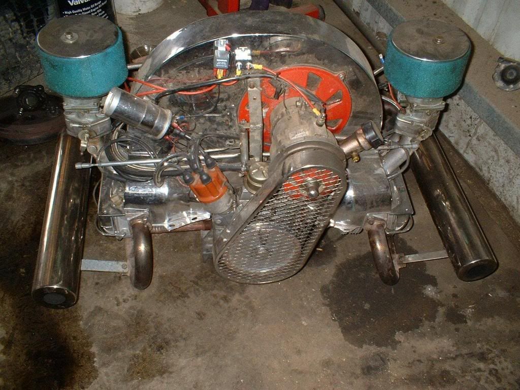

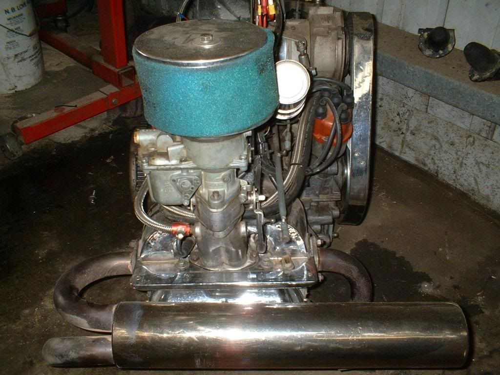

Hello all. I was wondering if anyone could offer a simple solution for a problem child.
The beast concerned is a Rewaco trike fitted with twin Solex H40s that ice so badly the thing will not go during the winter months here in the Central Tablelands of NSW.
I have sucessfully fitted electric early fuel evaporation grids out of a Ford Meteor but unfortunately they are not designed for continuous duty and eventually burn out.
I have heard there is some sort of "electric blanket" that wraps around the inlet manifold available, although I've yet to see one.
Thanks for any help

Looks like that engine is out of a Trike or Buggy
you need to make a metal shroud up to fit in front of the carbies to stop the wind blowning past the mainfolds

after looking at the pics again
You may be able to use four electric blankets on your inlet manifolds
if you can find them in Australia..
or go to a single carburetor with heat riser heated inlet manifold....
Lee

Yeah i have a Trike with the 1916, twin Solex and similar chrome shrouds.
I don't experience any icing despite the cool weather altho my 1600 Super bug with the solo carb gets a little icy at times due to the heat tubes being blanked off, but not enough to cause any running problems.
I have noted there is a fair amount of warm air blowing thru those holes the spark plug leads go thru right next to the intake manifolds. If you could somehow redirect the hot air from these holes to run over the manifolds it may help?

I used to have a similar problem when I ran Kadron's on my old 1640.... but I had the vent area above the butterfly icing up, not below the butterfly or the manifolds.
Solution a carb place told me was to do away with the insulator in the middle of the carb - between the butterfly and the vent area, which is the white part (nylon?) you can see in your pics. Instead I had a cardboard type gasket there - the theory was it would transmit more heat from the manifold up to the vent area of the carb. Seemed to work pretty well - at least I didn't have them icing up in winter any more !!!
