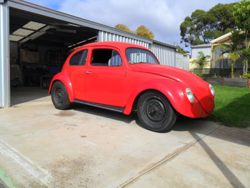

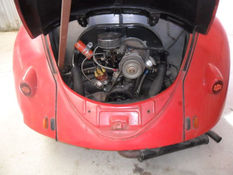

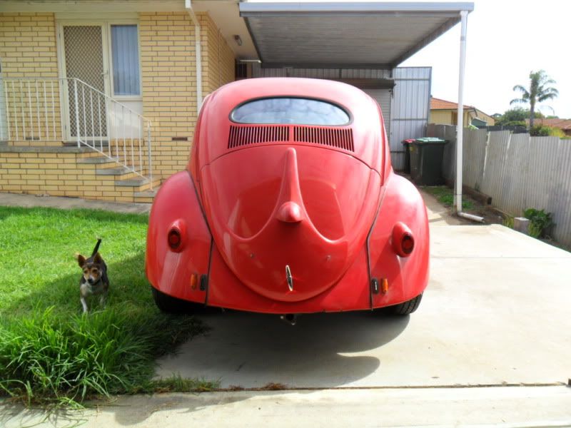

56 Oval
Recently purchased this '56 Oval. Fitted with a 1600cc. Paint looks a lot better in photos than it is . Rust at bottom of door pillars to fix .
Need a pair of front seats, can anyone help ? Or if I use seats from another car what do people recommend ?
Needs Bumper bars too !

saw this on ebay... congrats mate.
is this another oval import? or graft? as i see it has no semaphores either!

I believe it is an Australian assembled car. Don,t know what you mean by "graft" sorry. Semaphores have been filled in by a previous owner.

wow... another beetle with filled in semaphores. :( . been so many lately.
a graft is another term for some body work. fitting a window etc.
i had grafted an oval wondow to a 66 beetle many years back...

It's not an oval graft, the windscreen is oval as well. The semaphore's aren't neccessarily filled in either. Not all ovals had semaphores.

all australian ovals had sempahores... didnt they? i know US models used splitty blinkers mounted low on teh front guard. i did this on my ol beetle as well...

The rear apron isn't original to the car - a 56 should have the cutouts for the exhaust.
The taillights are sitting high for an Australian bug, but correct for a US bug - which means that if the rear guards are original then semaphores may not have been fitted either. I'd have no idea why a US oval would be over here though??

I would say they filled the exhaust cutouts on the rear apron in,if it was a us bug it would be left hand drive???.

Yes , the exhaust cutouts have been filled in !
I think the tail lights look high because of no bumpers ! Looking for some if anyone can help.

Pretty obvious the aprons cutouts have been filled
You can see the bog starting to fall out where the the right side cut out has been plated and filled.

With all due respect to your knowledge, I think you will find the taillights are spot on where they are supposed to be for a set of snowflakes,There is no difference in height from country to country, heart taillghts were lower. Both front and rear valance are correct for the year so all in all it looks very good and solid. I don't know what was paid but it looks extremely easy to restore/hotrod/whatever.
